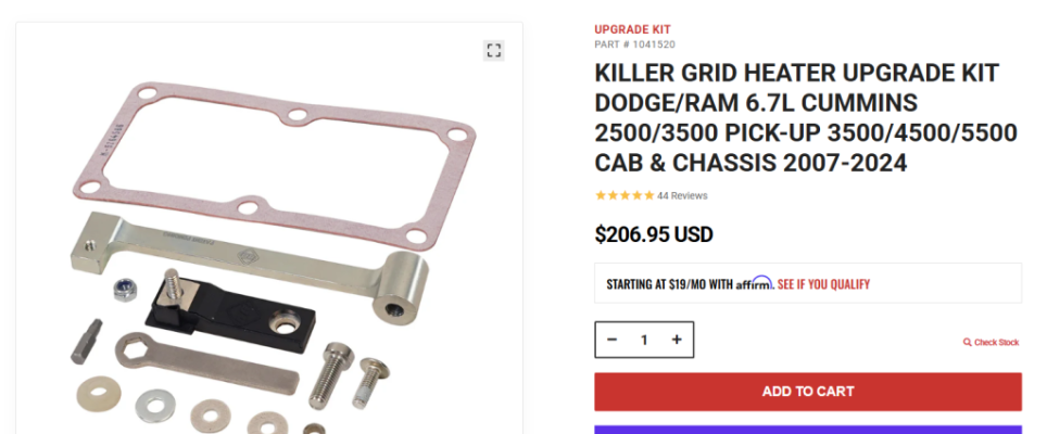

Don't waste your money on a name. If you want to do it... by all means do it. But you can get one of these much cheaper and accomplish the exact same thing without paying the Banks tax. That fancy intake horn doesn't flow anything more than factory. (Been proven and easily searchable)
I've been a fan of Dave for years until he started hyping up Banks.

Let it be known though, that kit above does not fully cure the issue since it still has a fastener that can fail in the intake. Also people seem to have issues following directions and properly installing that kit, causing shorts.

That's not a fault of the hardware, that's a fault of the installer. It's still using a form of a glowplug instead of a grid heater, and that glow plug tip can still break off and fall into the intake. There's no real way to completely eliminate the chance of something falling into the intake without just deleting the heater. Ford went through glow plug tips breaking off on the 11-13 Powerstrokes.
If you want a 100% fool-proof way to prevent anything falling into the intake, a full delete is the only way.
Not a glowplug. It uses a heating element coil that is used on other systems.

Not trying to split hairs, but it is very similar in function to a glow plug. It's a coil inside of a metal tube with ceramic insulation. Both have the capability of breaking off.
