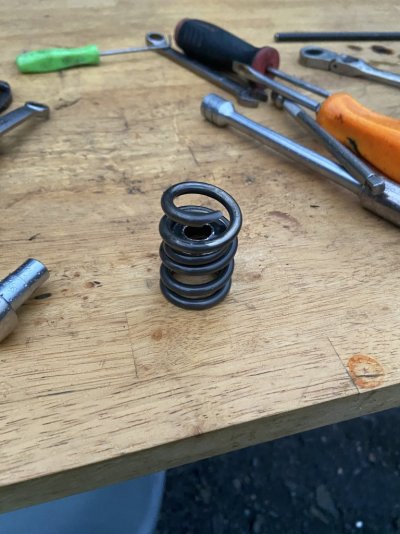

Thanks for your help , found the issue , see photos . I didn’t think this could cause the issue , but it did
that didnt throw a code or have any tick? wow nice catch

Have you looked at the piston & valve with a borescope? That exhaust valve most likely fell in unless the spring cap & keepers stuck to the valve stem. You can get s scope at harbor freight or amazon for less than $100.
