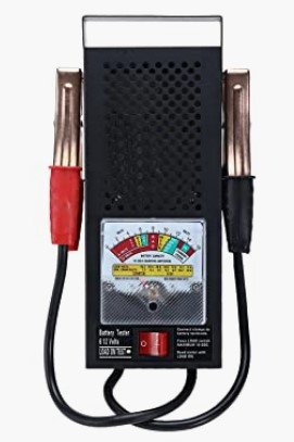

Have you measured the voltage before starting the truck and at a high idle? And a load test using an old style toaster load tester will provide definitive results as to the condition.

Toaster load tester? I'll have to Google that. I have a multimeter I can test with.
