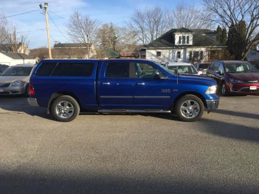

The one difference is where the Front of the topper meets the cab. Quad cabs are different than crew cabs. Also 2017 to 2019 there are slight differences to quad over quad, and crew over crew. That shape is a bit different but with a little careful maneuvering the Canopy will fit right on.
Quad cab topper on a Crew cab, notice the larger gap at the top. If you try to put a Crew cab topper on a Quad cab you may end up being a tad to close to the top of the cab.
Crew cab topper on a crew cab (2021 2500 Laramie), notice how much more forward curving the crew cab back window is compared to the Quad cab more straight up and down.

This thread should help. I fixed the above comment, I had quad and crew reversed.

not sure how going the other way will be but I sure have seen a lot of earlier ones being put on 19 and up that look funky where the cab lines up with the topper..they fit but they just look funny.
