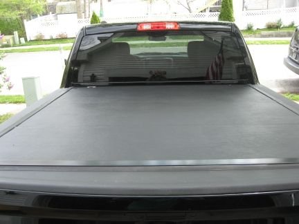

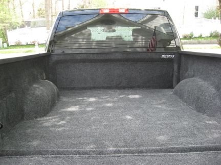

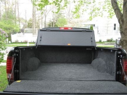

This morning I installed the BedRug and BakFlip VP for my 1500 Express.
Had a BedRug in my last truck and knew I had to go that way on this one. Also had a folding hard cover, but it was one that didn't fold all the way like the BakFlip VP. Some of the side rubber on the cover still needs to relax some from being all packed up, but from all I have read, if the sun doesn't take care of it a few minutes of heating with a hair dryer will do it.
Installation was without drama and with me taking my time both mods was just over 3 hours.

The Velcro holds everything very securely. Once in place it is not going to move and it actually takes a strong pull to get the Velcro apart. I had one in my Dakota for 5 years and never had an attachment point come loose. Over the time I had the BedRug in the Dakota it carried everything from mulch, lumber, furniture, and paving stone and still looked great when I traded t truck in.
I think the BakFlip VP looks great on the truck and while the install instructions were very lacking it was pretty obvious how the rails attached and a easy install.

Cutting for the tie downs was simple. Once I dry fit the liner and had it all tucked tight and how I wanted it all I did was use a box cutter and felt where the tie down was and cut along the edge of it until it was starting to poke through and pushed it right through. The slit is barely big enough to fit so when the rug is pushed tight against the sidewall of the bed you cant even tell it is slit. took about 30 seconds for each one. I should have taken a picture of them but didnt think of it.
The BedRug doesn't create any problems for the BakFflip rails. As I said before, the biggest issue with cover install was that the instructions really had no detail, but once you lay the rails out it is pretty obvious how they install. Just 3 clamps on each side. It comes with drain tubes but I didn't install them. Had some rain last night and didn't find any leakage. Next test will be driving with a good rain to see how much, if any, wind blown rain gets in.
If you have room in garage you may want to remove BedRug from box so it can have time to relax and lay flat. isn't critical, but probably saves a few minutes laying it out to zipper it if you are installing alone like I did.
