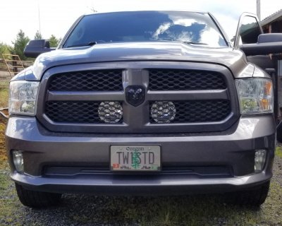

I have a 2014 with the active grille shutters. For years I have been reading about how there isn't a way to put lights behind the grille. I did some measuring yesterday and I think I can get lights in there. Ordered last night and if I can squeeze the time will attempt to mount this weekend. Trust that if they work I'll do a write up. I don't want to remove my shutters.

For years I have read that there is no way to get lights back there but I'm starting to think no one has actually tried. Installed these Hella 500FF's this weekend with no issue. Don't even have to drill the hole as there is one available with a speed clip in it. Active grill shutters were untouched. All went together way too easy.
