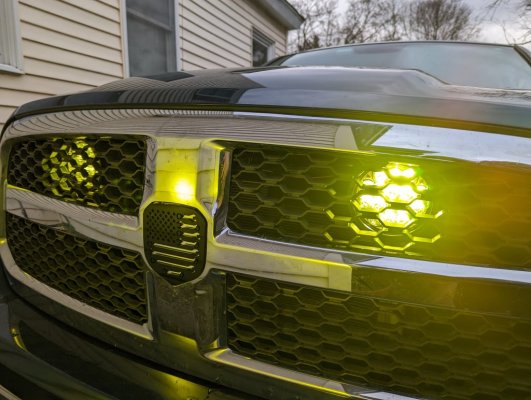

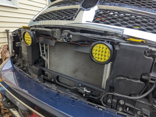

Decided to add some lights behind the grille. Went with some yellow just to add some contrast to the bright white highs, lows and fogs I have now. Wired up using the harness the lights came with, wired to the battery with a relay/switch. Mounted them to a tapped hole in the core support. I did have to remove the deflector from the both sides of the grille to fit them, but I don't think it'll be too much of an issue. If does, I'll pop them back on and move them inward some. Otherwise, they fit tight, not blocked by any of the crossbars.
