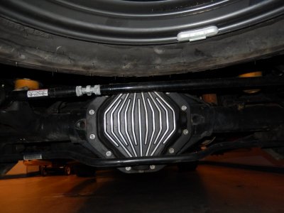

I think I posted this on blackouts thread but based on what I've researched and from the adjustable bar its self yes the bar will help you out some fixes it perfectly some like me just a small amount of wag and for me its only on rough roads
Basically the pan hard bar has to be parallel to the axle the sphon one really only fixes the centering of the axle side to side I've read only one person that has done this on another forum but the drilled a new hole for the bar and his was on the frame side (i will do it eventually when ever i get a chanve to) but if it is not parallel to your axle when you go on bumps your truck is going to want to center its self if your bar is lower then the axle it will pull the the right going up and back left going down vice versa if its parallel yes it still pulls but it will be balanced but want to retain that center and just go up and down

I was the one that drilled the new hole. I raised the panhard bar on the frame side as far as I could and it helped a lot. I only have a 2" drop, but I still had a little wobble and I hated that. With the bar raised on the frame side it helped a lot.

No it wont fix it i put the panhard bar on and it was good for about 6 months now its back so be for warned and it cost you 700 for a drop WTF lol
ya but with 4'' drop are bars are more level unlike the 2'' drop
