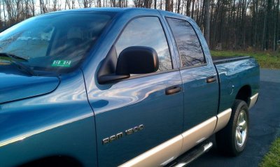

I have an 04' 1500 w/20" stock wheels and tires. I am looking to do some performance tweaks (I.e. intake,header,chip, etc) but I would like some advice on what is going to give me the most noticeable difference in performance. I'm not big on the top speed, and since I tow I would like more torque, quicker shifting (if possible) or if nothing else better gas mileage.
Any help/advice would be appreciated!
