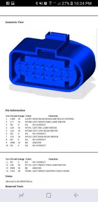

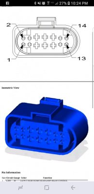

Found this through a link on here. I'm sure you figured it out, but for future searchers...it helped me
Screenshot_20180913-222402_Hancom Office Editor.jpg Screenshot_20180913-222418_Hancom Office Editor.jpg
