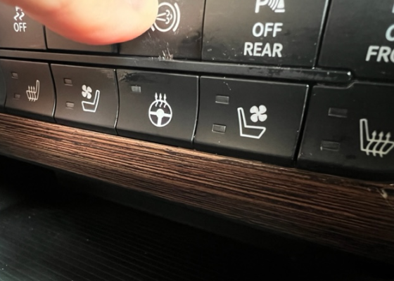

Take a picture and post it. I will see if I can help you figure it out. Im leaning towards Shine Supply solution or Koch Chemie ASC.

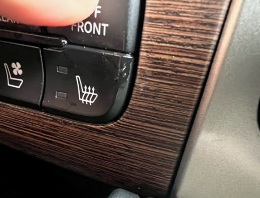

You can see a little bit on the center console. It's clear and super sticky. Not sure what it is but I've seen silicone tire dressing (I think it was Eagle One) get really sticky like that. To note - the tires were coated with a similar mess as well. It took a lot of effort to get it off the rubber.

View attachment 530957View attachment 530958View attachment 530959
I would get these two things and clean them really good. It won't hurt the buttons. I use it on most all of my details.

How’s the radio? Has it ever been replaced? I ask because your truck is a 2018 and the 2018’s are notorious for the delaminating 8.4 radio touchscreen. I’ve seen a defective radio leak the LOCA or liquid optically clear adhesive. It’s super sticky and equally hard to remove. The buttons you show in the pictures are directly below the radio and the prime spot for the adhesive to drip down onto. You could have a defective radio and it will continue to happen over and over even after you clean the buttons or its residue from an earlier replacement/repair. That button panel is removable after you remove the center stack trim. It’s secured to the trim ring from behind by phillips screws. If it is LOCA it comes off with isopropyl alcohol but scrubbing the buttons with isopropyl alcohol may remove the black coating/paint.
Just get some electrical contact cleaner. Safe for cleaning terminals and the plastic. Should rinse out any grease or whatever is in there and then evaporate away. Disconnect the battery first if worried and give it a few minutes to clear out.
No it hasn't been replaced and yes I am aware of the issue with the 2018s. My last one was also a 2018 and I replaced the radio in it. I am going to be replacing the screen in this one down the road. I mentioned in one of my threads that the glue is the glue from the screen. It's not showing signs of delamination but it is.
I've removed the switch panel and tried cleaning with isopropyl and all it did was essentially remove some of the paint from the buttons. I've got to attempt to disassemble the switch panel to get underneath the buttons.. that's where the glue is sticking.
I did try electrical contact cleaner as well and it had no effect.

I've had the buttons fail in the past as well. The metal bits that act as button returns broke internally. They still worked most of the time but they didn't click like they once did. Eventually I just replaced the panel. Hopefully you manage to get it cleaned out and it works, but glue is pretty tough to remove from electronics without damaging anything. The solvent to remove glue is pretty tough. 3m makes an adhesive remover that works pretty well, but you'd have to take the switch apart to get it in and out of there. Take a pic of the panel. Maybe one of the members that has switched it out to add the aux switches happens to have one off a truck with the same options they can sell for a reasonable just in case https://www.rockauto.com/en/catalog...switch+&+relay,instrument+cluster+switch,4524

When i saw that, first thing that came to mind was the sticky stuff that is used to apply Automotive wood grain vinyl.
The second thought was a delaminating radio.
Just this week, a video was posted that shows exactly how to disassemble the Auxiliary Switch Panel
