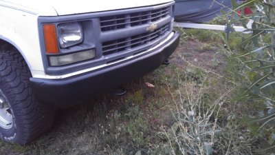

20200807_202955.jpg 20200823_170250.jpg Prep is a big part of covering chrome.the crap is tough and slick.scuff with a side grinder and a flap disc.Raptor liner hides alot. An even scuff is not important.!! Your making something for the liner to hold too.use adhesion promoter.and make sure everything has deep scratches all over.some places use a file where there grinder cant get...!! Alot of prep but the finish product is well worth it !! No more scratches or rust!!!two coats of liner thin one first let it flash dry 30. -45 min between coats.shoot low going up as gravel and road salt will .lay on the ground if you have to.. I had to reshoot alot of the lower stuff cause i didnt get low enough.

60 grit on a side grinder .rougher is better.use raptor or bulldog adhesion promoter! Anything missed with sander/grinder use a file.the raptor liner hides all uneven surfaces so scuff away! Shoot two coats one real light then second 30-45 mins apart.unmask before it hardens! Done right its awesome no rust or scratches to ever worry about.good luck
