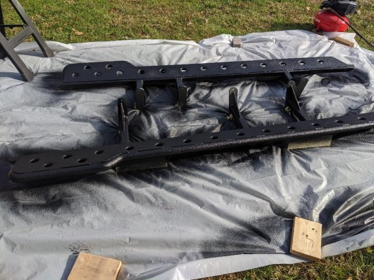

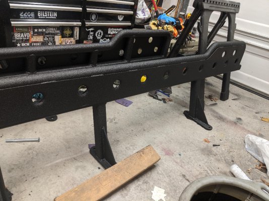

I did raptor liner on my rock sliders and the key to that stuff is prep prep prep. I sanded with 80 grit, cleaned it thoroughly, used the acid etch and adhesion promoter. I used the 4 bottle kit on my sliders and I got a solid 2 coats and a light 3rd. You'll get a bit of overspray. Its holding up well on the topside step portion of my sliders but it rips off in chunks on the bottom from hitting rocks. All in all was really easy to apply just the prep is time consuming.01b6f3fc7f88b5d472e97bd029cf37d4.jpg7abf8a74d7e8d68649dc8599cd281da5.jpgfe4eab31a951909dcb145f6b24054fcb.jpg
