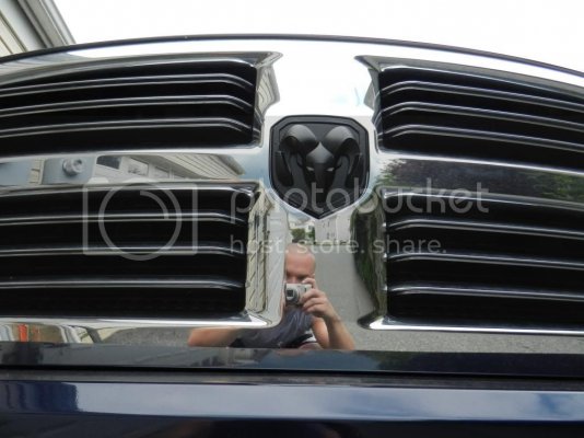

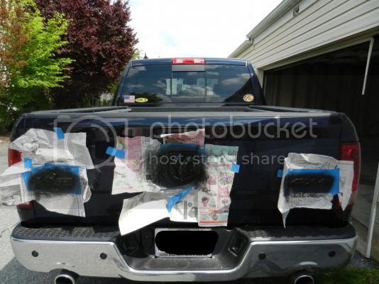

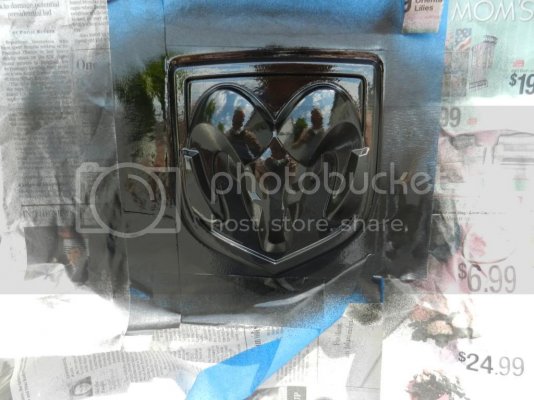

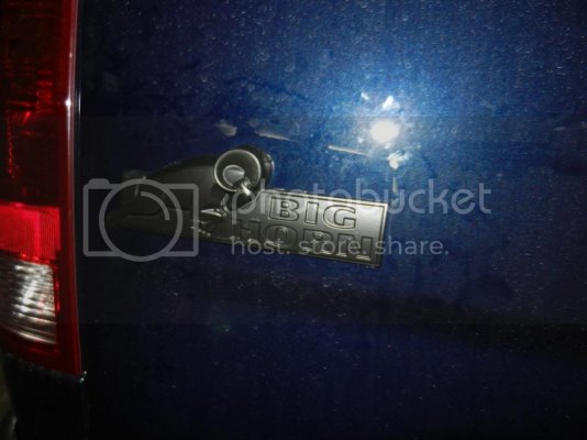

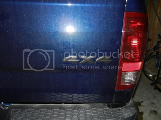

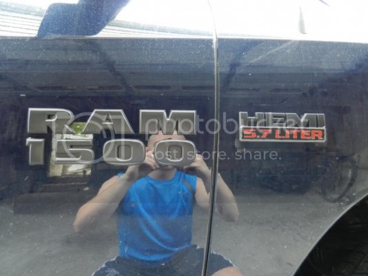

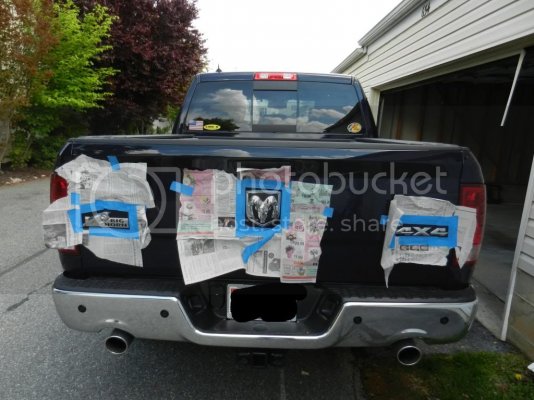

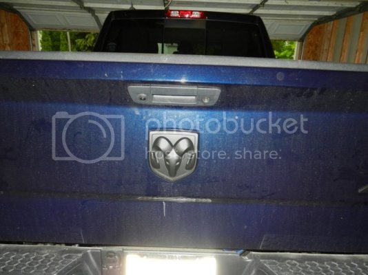

When you tape off the area around the badges and lettering, leave some room so that you DO get plasti-dip on the actually paint of the truck. That's not a typo lol. Just do around 5 or 6 coats of the plasti-dip and it peels right off the truck paint but stays on the emblems. Here are the pics from my plasti-dip project that I did last week. You can see the amount of paint I left open. That paint all got plasti-dipped and then I just peeled the stuff right off afterwards. Now the paint looks like it was never plasti-dipped and my badges look awesome!!
Hope this all helps.
Pics:
I left the red lettering of the Hemi badge stock because I liked the red look. Just covered it with painters tape so no plasti-dip got on it:
Pics:
Any reason you left the dip in the small areas? Think a toothpick and such would work to get it out

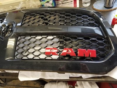

I would not put that dip crap on anything. Mask off your truck and paint them with real paint. It will not peal off like dip stuff does. I painted a set of black door letters red with automotive paint for my grill20171209_140711.jpg

I would not put that dip crap on anything. Mask off your truck and paint them with real paint. It will not peal off like dip stuff does. I painted a set of black door letters red with automotive paint for my grillView attachment 130186
Maybe he doesn't want to spend the extra money or have it be permanent:hmm:
