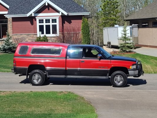

I use Rust Check, which is an oil based film that they renew every couple of years. I have a local place that does the applications. Pickup was $450 first time, then about $200 per respray. I had them drill the holes and spray the hard to reach places. They seal them with Rubber plugs so it looks OEM. Had them do my new 2021 as well. Krown is very similar and just as good. Alberta has a lot of salt and 6 months of bad weather.
This is my 1996 2500 and the picture was taken this summer. Original factory paint, no rust anywhere on the body. Undercarriage is pretty good too, but you can't completely eliminate rust. Was kept Rust Checked and washed at the wand wash at least weekly, sometimes more, because I hate driving a dirty vehicle.
