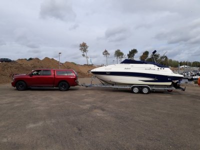

Wow that’s a damn big boat. I dream of having a boat with no maintenance required
Blue Streak Pearl off-road
Don't we all dream of stuff with no maintenance required ;)
But if its got moving parts, you got to service it. Unless you can sell it before it brakes :)

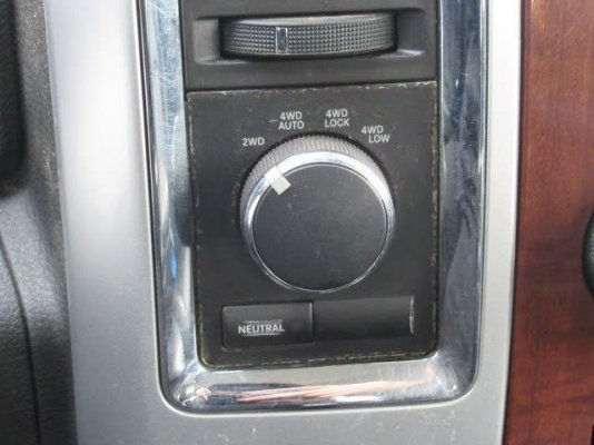

Don't think there is any 4x4 high. You can only choose auto, lock or low for 4WD
This was the slipway where we went to get the boat. Have no idea what the conditions will be where we let it in the water over here. Guess it will depend and be different in any other location. That will be something we will find out next year.
depends on the tcase...mine has 2wd, 4wd auto, 4wd lock (which is 4wd high) and 4wd low (which is always locked), and of course neutral
Your manual will tell you which is which.
I'm not sure what the European version of the Laramie has but this is a 2012 Laramie 1500 4X4 shift here. IAC use whatever 4X4 you have and heed the instructions I gave about pulling out of the ramp. Nothing more embarrassing than spinning your wheels when there's a line of boats waiting to launch/recover.
