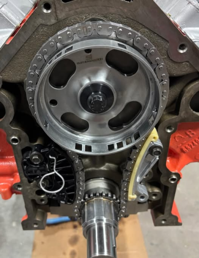

Home of the one and only billet sprocket timing set & phaser eliminator for the VVT Gen3 hemi. Ruggedly tested to over 1650 hp with an entire season of runs already.
Priced below a OEM phaser (locked out) and without the potential failure of the sheet metal sensor cage and/or phaser mechanism while loosing over 2 lbs off the cam nose. Upgraded attachment hardware and better clamping than OEM.
Demand this upgrade on your next swap/race build. In stock and ready to ship.

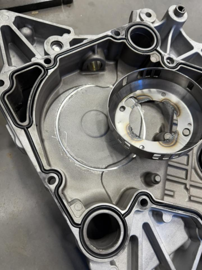

This is what the phaser looks like when it fails.This is my buddies old phaser off his Hellcat.It's an expensive fix if the phaser comes apart :rolleyes:

Does that eliminate variable valve timing?
Yes,but the majority of bigger aftermarket cams lock out the phaser,so you don't have VVT.It's done to help prevent piston to valve clearance issues as the hemi's an interferance engine.
If you look up the upper cam gear for the earlier non-VVT 6.1's,this is very similiar to their cam gear.
