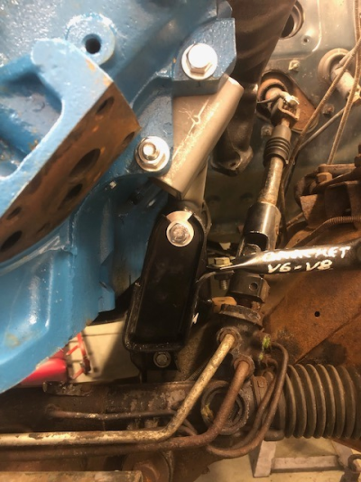

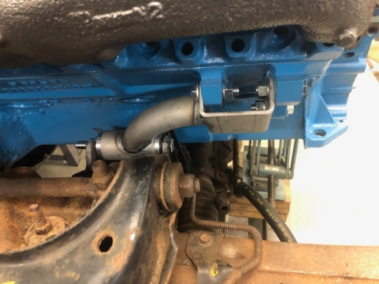

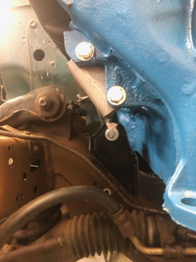

I know there is a modern hemi craze going on these days but I always wanted to do a big block in my 1995 Dakota. You can make a good amount of HP with the big block without breaking the bank. I have also received a lot of interest in this swap. So, I decided to make a set for myself and make a fixture from those to make more of them for sale. Instead of making a separate frame bracket extension in which to make a motor mount attach to, I decided to go the other way and go from the motor mount ears on the block back to the OEM V6/V8 frame brackets. This will also reduce the weight of the mounts. I will post when these mounts are ready for sale.

Only thing I see that I wonder about is no vibration insulator. A cam'd 440 would shake the fillings out of your teeth
