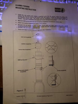

After watching several install videos I have seen the washer that comes with the 5100 installed under the strut nut and on strut BEFORE reassemble of strut spring . The instructions are not real clear on this .
So , where does the washer supplied by Bilstein go exactly ? Before reassemble or under the new nut on top ?

Before the strut mount goes on you install the washer because the shaft can go through the strut mount without the washer on. Do no put the washer on top of the strut mount because it will pull the shaft through the strut mount.

^^This, the washer goes on before the top mount, it never touches the nut
