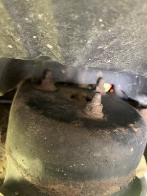

i have a 2014 ram 1500, had bilstein 5100's installed about 6 years ago in the front, i havent been that easy on them. lately i noticed that the drivers side is sticking up from the strut tower about 2", the passenger side is fine, cant see the nut at all as it is recessed. anyone know whats going on here? strut mount? bushings? garbage shock? help!! picture of both sides below...

Heh, looks like the washer's missing. You're going to need new upper strut mounts and from the looks of it a new set of Bilsteins. This time with the washer installed, ideally :)
Plus side you'll love how it rides after that.

Time for an upgrade. The newer Bilstein 5100’s don’t have the “washer” anymore. They quickly found out that 3/4 of people don’t read directions. OP there is nothing wrong the upper strut mount failed as they all do. It’s been making noise for a little while from the looks of it

so i have a bad upper strut mount? replace that and im good to go for a little bit? trying to do this on a budget as im leaving for work in a couple weeks, and will deal with the rest when i get home in november.

No you will need struts and top hat

If you just replace the strut mount and re-use that strut, the new strut mount will only last a few days or maybe weeks if you are lucky. Unfortunately, I am speaking from experience. Ha.

This is true every costs more the 2nd time you do it

@wilytangs i also highly recommend doing both sides

thanks guys, ended up buying 2 new complete strut/spring assemblies yesterday. hopefully that does the trick

Yes, there is one on each front strut. In nearly all instances it is a good idea to replace both left and right at the same time because if one is worn out there's a pretty good chance the other one is just as badly worn out and may simply not have catastrophically disassembled itself yet. It's less work overall to replace them both at the same time vs. replacing one, then replacing the other one a month later - and in the case of suspension components an alignment may be needed after each replacement so that's one alignment rather than two.

I'd bet that the washer rotted off, judging by the look of it. I recently did 4600's on my '18 and was shocked at how rusty the top of the stock shocks were.
I heavily coated the top of the assembly with FluidFilm and covered the hole in the mount on the frame to keep road **** out somewhat.
