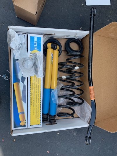

Installed the kit this morning.Not bad job to do in a couple hours. Also installed adjustable track bar and had to move the axle to the passenger side by a 1 1/2. Then had to adjust the steering wheel by a half a turn. Very easy to adjust steering wheel. Next up is an alignment and we should be good. Kit was on sale for 600 bucks. Not bad for what you get. Adjustable track bar was 220.00.
Out with the old.
In with the new.
