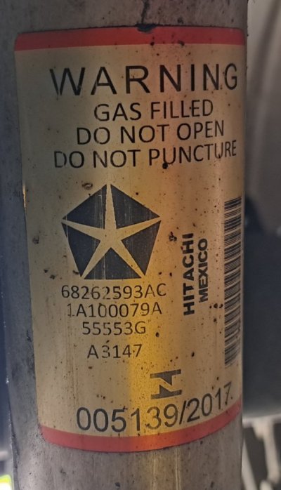

I wanted to follow up on this, in case someone else has this issue. The ORG option does indeed require it's own rear shock. I couldn't find an answer anywhere, even tried AI, but that gave me the WRONG answer. I emailed Benny's group, but they didn't answer very quickly.
So I went out and looked at the shock, wiped off the dirt, and right there was a big beautiful sticker that had all the numbers on it (copy below). Once I had that number - 68262593AC - I was all set! My new shocks should be delivered today.
Moral of the story: when in doubt, look for the part number on the part itself (if it's OEM).
