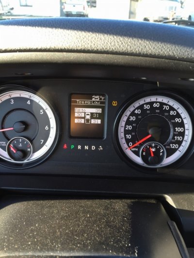

Also my tire pressure light is on. Picked it up last night n it was fine. Started it this morning 21 dg n 3 tires showed 30 they were all at 35. What should they be ran at
Stock is 34 psi cold on 20" wheels.

So I shouldn't worry about it. Just let it go n don't put air in. I know they warm up but I was just wondering cause it was so cold
No, you should drive to the nearest place you can and air them up to 34 minimum. It would be even better if you could air them up without driving anywhere after letting it set overnight. Driving will cause the air to expand /heat up so you won't have a true "cold" reading.

Thanks. I can air them up at work but have a 40 min ride home so I'll just wait and see what happens. I need an oil change so the place I go will do it. They did it before. I just want sure cause there bigger tires idk if they needed a different psi
If your tires aren't stock, the PSI may vary, but the factory recommendations are a good starting point. 34psi should be the minimum in all temperatures. The tire manufacturer's Max inflation rating should not be exceeded.
The space between these two values is up to you. More psi could net better MPGs, but may reduce tire life and or result in poor wearing patterns (same goes for under inflation).

The tires say cold 80 psi. What should I run them to?
I called the guy who did them. He said run them at 38 psi. There e rated tires and I could run them at 80 but it might throw sensors off for to much air.
38 sounds like a good number. It becomes subjective unless you go to the lengths of chalking/painting the tire and observing their footprints at different PSI ...
For keeping an eye on them or not worrying about, from research this is highly subjective and you should do what your comfortable with.

2) I know different tires require different PSI's and it also depends on what they are being used for. I can't say for sure on what you're using now, but my stock Goodyears are using 40 psi. My sensors are set at either 38 or 39 psi... anything below that, and I get a low tire warning.
