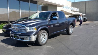

This is my first post, so let me start by introducing myself. I just bought my first Ram truck (2014 1500 Laramie Crew Cab 4x4 Maximum Steel). I love my truck, but cannot stand the aluminum clad wheels. I have my eye on a set of Fuel Hostage (chrome) wheels with Open Country A/T 2s. I want to level the front end to prevent rubbing...and that, finally, leads me to my question. I talked to the local wheel shop today and they suggest a ReadyLift level kit, but a lot of the research I did on here was leaning toward the Bilstein 5100 adjustable struts. I would like to get some input regarding pros and cons of going one route, or the other.
Thanks in advance for all the help! I added a picture of the new love of my life (after my wife and daughter of course...)
