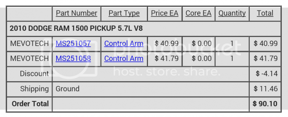

Buy the Mevotech UCA'S! I cost me $150 shipped with exchange into Ontario for them. They are much more heavily built than the stock ones and if you're not doing heavy offroading why pay all that money for the Zones?

Just go with a Rancho quick lift system. Great ride and no UCA problems
Part number? I can't find them on Mevotech's site......
Ya... but xrsman lists in his profile he's got a 2014 as I do.... I'm looking for a 2014 fitment........
Those are the correct ones for a 2014. The system will not pull up that part number for the later model trucks so you must search for an earlier year.

Yep! Those are the right ones!
