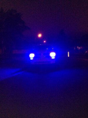

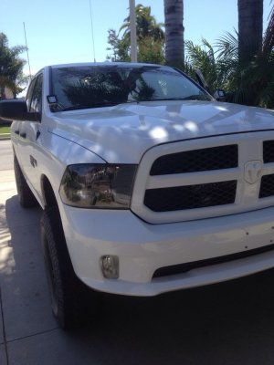

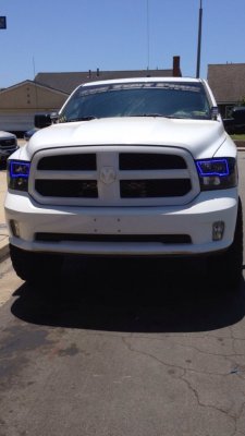

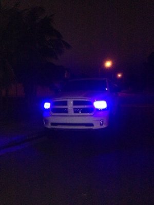

First I want to say, JJ you are talented and have a lot of patience. I just finally got the balls to do the headlight housings and man was that a process. Baked at 250 for about 12 min do get the glue workable. They aren't perfect but the imperfects are tiny. Just glad I got them back together. I want to buy another set of stock headlights and give it another try with some more creativity. Anyways here's some pics for you guys. ImageUploadedByTapatalk1400700940.256095.jpgImageUploadedByTapatalk1400700968.473137.jpgImageUploadedByTapatalk1400700979.338825.jpgImageUploadedByTapatalk1400700989.005366.jpg

Just looked closer at your pics. How did you mount the LED's at the base of your windshield like that? Any closer pics?

Thanks guys ! Like I said there's some imperfections but you can't notice unless I point them out :)
I believe it was permasealed. It was black and once it cooled it was very hard plastic.
It wasn't difficult so to speak but was time consuming along with patience.
Just be careful when sticking things in to pry them open. I used a flat head screwdriver at first but soon realized it was too much. So I used these hard plastic tools I use to pull door panels apart.
I Fabricated a mount out of very thin scrap metal almost like an L bracket. I also fabricated a flag and light mount for my bed ImageUploadedByTapatalk1400746351.640444.jpg

Here's a pic with my 5k 55w HIDs installed
I love my headlights now. Should keep me satisfied for a while.
