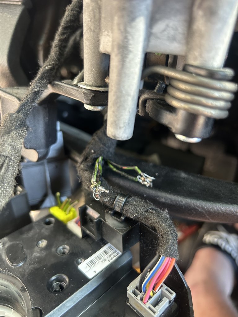

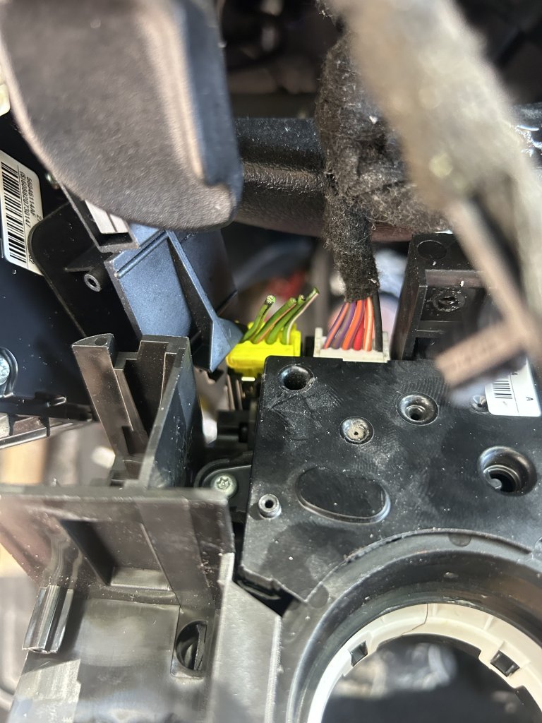

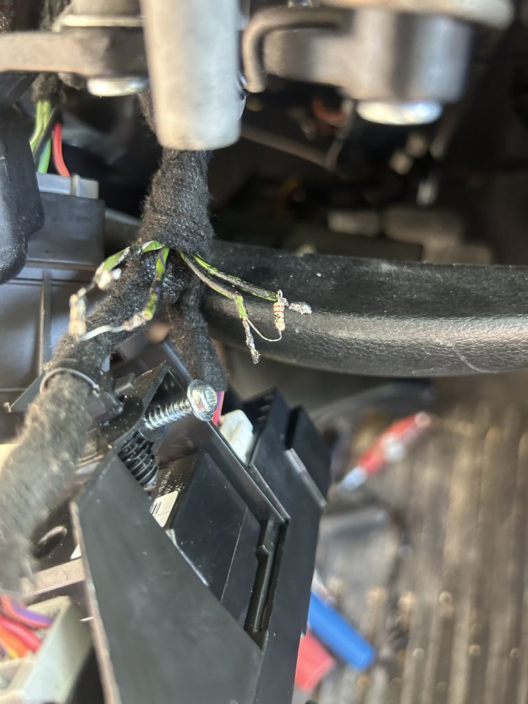

I recently bought a 2019 Ram 1500 tradesman classic. The steering wheel buttons did not work. After searching for a solution it seemed the clock spring was known to go bad so i ordered and changed it. During the process of changing it I found a wire clip had been cut and they connected the wires together with resistors. I will add some pictures. Now i assume this is the airbag first because of the yellow clip matching the yellow clips into air bag. I didnt want to get into a bunch more work currently so i just left it how they had it taped the wires back up and put everything back together.
The steering wheel buttons all function now along with the horn etc so i assume the clock spring was bad. The airbag light came on and i got a message to service airbag system(which was not on before). I would of thought the resistors were a way to trick the system into thinking the airbags were hooked up but as soon as i change the clock spring the light comes on so maybe they did nothing at all or thats not their purpose? I just dont see what you would go through that trouble to hide the code with resistors if the broken clock spring was what was masking the problem anyways.
I guess my question is if i wanted to fix this myself would my next step be to put the wires back into the connector and see what happens? Any suggestions? Also i assume if i take the clock spring back off to fix it later i would need to buy another new one as i pulled the pin out to hook everything back up?

Is there an airbag present? Was the airbag stolen or something?
It's hard to imagine someone doing something that stupid. Makes ya wonder what else they might have covered up to get it sold.

The air bag is there. I can see it in the back of the horn/airbag assembly. As far as the curtain and passenger bags i don't know.
Edit: Yeah it does kind of make you wonder. I have put around 2k miles on it since buying it and everything seems to work/run perfect(except the steering wheel buttons which now work).

wow! good find! if you were ever in a crash that airbag would never have gone off!
they clearly disabled it and tried to hide the fact with the resistances fooling the light. thats almost criminal. definitely worth looking into who did what where!
yes its possible the clockspring was the cause of the airbag light in the first case but obviously diagnostics is too hard for these people.
im not sure how to check an airbag, safest way would be to order a new one, solder the cut wires and follow the procedure for installing a new airbag
are the cut wires harness side or airbag side? if airbag side they will likely come with a new bag. if harness side you must repair.
its entirely possible that the airbag is good and that there is another problem elsewhere but you must repair the wires and plug in a real scanner to see whats going on computer wise.

The clip that was cut does not go directly to the airbag. It goes into the back of the clock spring. Then out of the front of clock spring is the clip that goes into the airbag which is all intact. I have the old clip because they plugged it into to make it look complete. So my best bet would be repair the clip plug it in and see what happens from there?

Just a small update.
I did pay for a carfax on the vehicle and it didnt show any accidents. Which i just means no reported accidents. I borrowed a decent code reader from a friend and the only codes i got from the srs system was
b0002-2b
b0001-2b
which are both "deployment control wires shorted together"
So im going to take the steering wheel back and apart and re connect them to the clip and retest.

Hello again. Just another update.
Turns out I didnt need the other clockspring for the reason i could access the wires without taking it off. I repined the clip with new terminals and plugged it back in and the airbag codes went away. So all good there.
