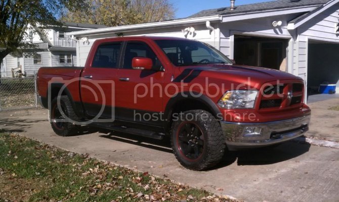

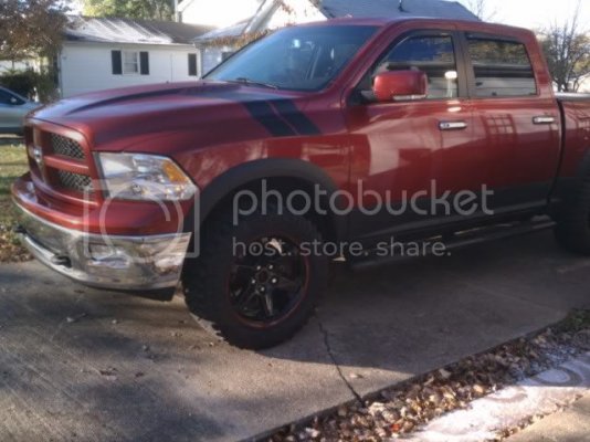

These have had the chrome clad ripped off and then painted.

those look great, i didn't recognize them at first look
is there anyway we can get some closeup pics of those wheels with the cladding removed. I never even thought of that as a option. they look pretty good in the pics.

Agreed! Id like to see some more too
