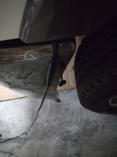

I have hard wired my tender connection to the outside of the front fender. My truck sits a lot, as I mainly uses it for towing an RV.
