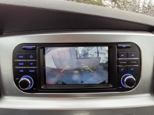

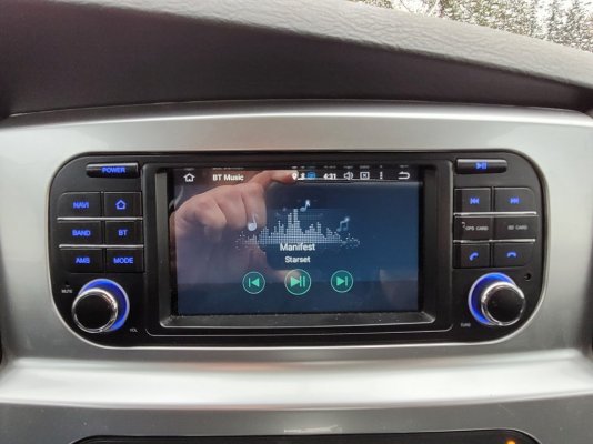

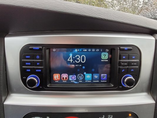

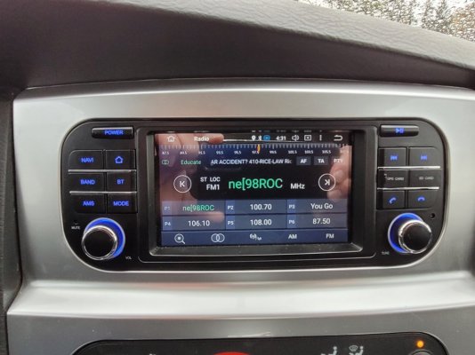

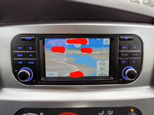

Can't help you there, I went with an Android unit that has it (and backup cam).

That looks nice!
I will admit it was pricey but was worth it for me for it's features and how well it integrates (most aftermarket head units won't work with the stock Infinity sound system) both electronically and the dash opening.
