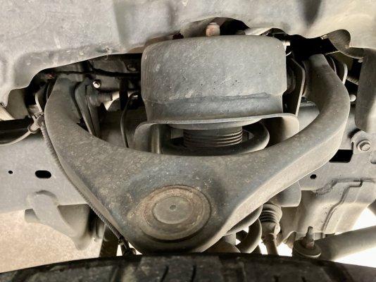

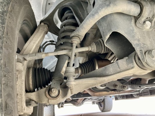

Bought my ram back in May 2021, it's definitely leveled / lifted some but I'm having a difficult time determining what exactly it has... partly because I'm a RAM noob. The suspension components all have MOPAR stickers on them, so I'm leaning towards it having some type of level kit (unless its a MOPAR lift kit but I don't think so).

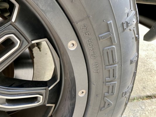

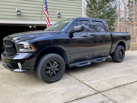

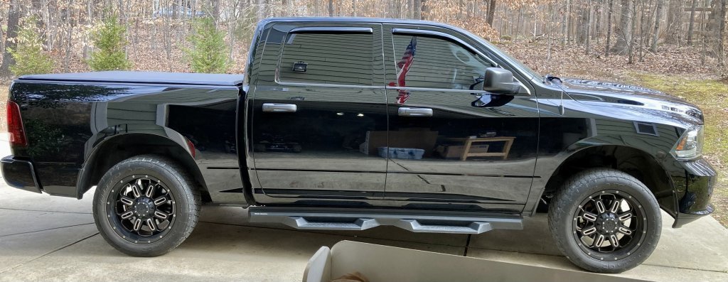

How can I tell what it has? It also has aftermarket tires which are SMALLER than stock for some reason, maybe the guy before me liked a little extra fender gap? They are 275/55/20 Terra Grapplers on GEAR Off Road Dominator 725 wheels. Speaking of fender gap, here are the measurements from ground to top center of fenders, are these variances normal or anything to be concerned with?
Measurements from ground to top center of fenders are as follows:
LF: 38 1/4"
RF: 38 5/8"
LR: 38 7/8"
RR: 38 3/8"
(Note the current tire size is about 1.08" shorter than stock)
Also taking to an alignment shop Monday because when parked on flat ground there's a noticeable positive camber in the front. Not sure if this has anything to do with improper level/lift.
Added some photos for reference. Any thoughts? I will need new tires soon and am trying to determine what I have "lift" wise, what size my new tires should be, and if its a decent setup or not (road driving only) before I spend the $ on new rubber. Many thanks in advance.

If that has a lift in front, it's just a spacer lift. Can't tell from the photos exactly because the spacer would be hidden inside that upper strut mount "cup", but all the stuff under it looks like just regular stock stuff.

Yeah you have a cheap spacer lift sitting on top of your strut. It’s probably a 2”

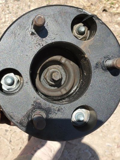

I don't know about those measurements but for the rear just look if there is a spacer above or below the coil springs. If the coil springs directly touch the axle perch and directly touch the chassis there is no rear lift. A spacer would be an obvious puck (steel, aluminum or poly) not welded to the frame or axle.
In front you can find the hole in the upper spring perch and look for a spacer through there. Not easy to see with the fender liner but it will be visible or you can hold a mirror or hold your phone camera to see it.
At stock height (no spacer) this rubber ring (circled) presses directly up against the underside of the chassis perch, so you'll see the bolt and shaft from the strut sticking up through that hole and you'll be able to make out this rubber part just on the other side of the ~1/16" thick steel chassis perch it's bolted to.
If instead it's some distance down that's a spacer. Like this:
There are some "small hole" spacers that don't give you as much view of the rubber bit... that would be a GOOD thing. These "big hole" spacers are junk because the rubber part is designed to push up against the chassis and if there's nothing to push against it will self destruct sooner or later and that means you'll need new struts, new strut mounts, different spacers... or eliminate the spacers and use lift struts.
The strut is located approximately 2/3 the distance from the frame pivot and the lower ball joint which means a 1" thick spacer produces about a 1.5" lift.
