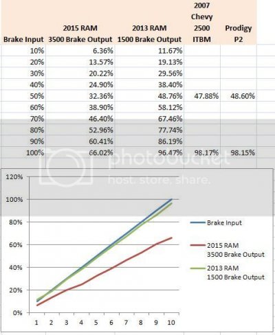

What Dannymk2 says is what I said several weeks ago. As far as the part about it being cheaper to ignore......currently, yes it is. But, i just cant see this problem not causing a serious accident where they will most likely have a huge lawsuit on their hands. You figure these trucks/controllers are new and people for the most part havent really had much time using the controller. So this is a ticking time bomb. This obviously affects the people that dont know about the issue and think they have working brakes cause they "somewhat work". Now, i dont know the figures on how many of these controllers were sold and if it affects the 16's (cant remember what conclusion we came to here). But all its going to take is one incident with a 25k truck and trailer going through a intersection cause someone cut them off. It already somewhat happened to boss and i also had a time where i had to stop my 5er quickly and had trouble. Fortunately, we are all alive.
As far as the nhtsa, that is a joke. i also filed a complaint and it was advised that everone here do the same. You can see in the link, or just do a search for 15 rams and youll see, there are only a handful of complaints regarding this problem. Seems like the only way this issue will get resolved is legally. Anyone here an attorney
