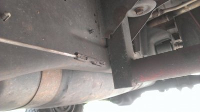

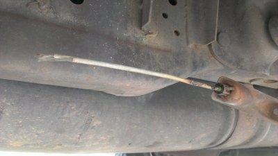

So I recently got back from vacation to find a nice size leak of tranny fluid under my truck. I think its leaking from the front of the transfer case though. Anyone know if there is a gasket or something that needs to be replaced?
Also while under the truck I noticed my brake line is busted.... right? Anyone replaced this before?
it's just one thing after another with dodge lol.

Emergency brake cable is easy, adjusting it properly takes a bit of patience. Looks like it rubbed on whatever is mounted to the body mount.
Looks like your leak is from the od unit to the t-case? I believe there's a seal or two in there, one on the trans output shaft and one on the input of the t-case.

Thanks for the help! That would explain why my emergency brake doesn't work... Any write up on how to replace that?
And thanks for the input on the leak.. Its ******* the wife off so Im trying to get that done quick ha.
