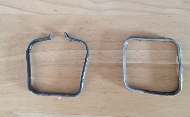

Solved !!!!
Had the same problem..no fluid leak..and no errors codes ...pedal to the floor.
It happened at idle or down shifting and worse intermittent..I thought it was
a vacuum leaks so i replaced hose.. nothing found..until I learned hemi
have an issues with gaskets in the intake manifold...so I tighten the bolts
and it went away for months until it came back...so I bought new gasket
and spent 4 hours changing them...and you can’t tell unless you remove the gaskets.
And one fell apart...Bingo
