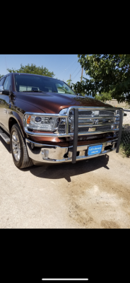

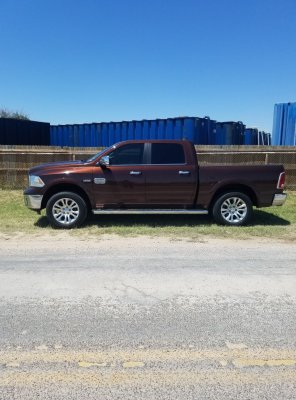

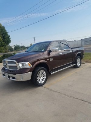

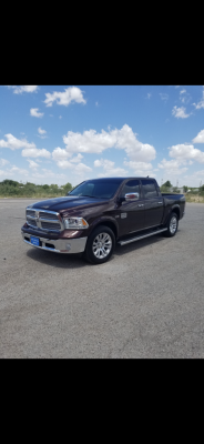

Stock from the dealership. Took off the grill guard. Wasn’t a fan....purchased this truck in July of 2016. It a 2013 Ram 1500 Longhorn 2wd 5.7L

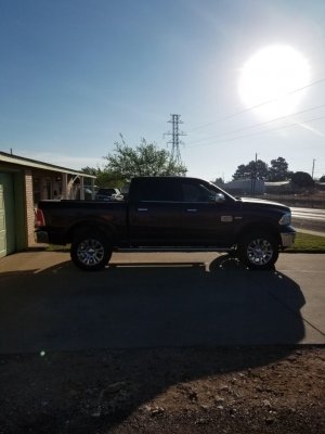

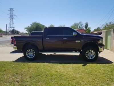

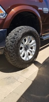

Now 7.5” lift (6” maxtrac lift w/ 1.5” Zone off-road body lift)
37x12.5x20 Toyo open country R/T

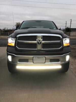

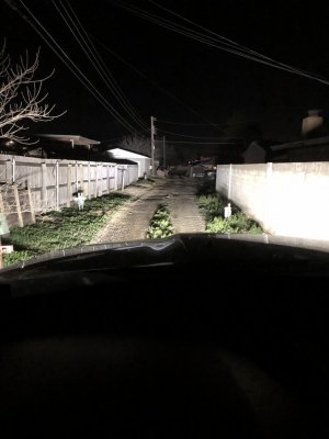

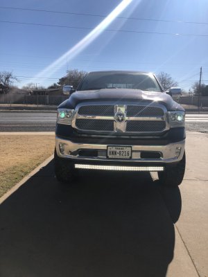

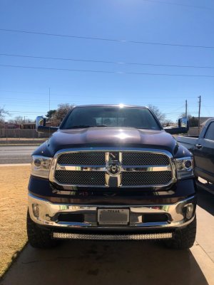

50” Curved light bar mounted under front bumper. 8000k H.I.D. Projector headlight and LED fog lights

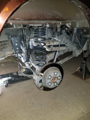

This was the truck leveled on stock tires. I think I redid the suspension 3 times lol

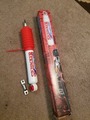

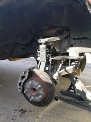

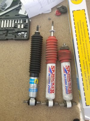

I wouldn’t recommend the skyjacker front shocks. The bottom of the shock holes didn’t line up with the bolt holes. The truck currently now has the Bilstein 5100 series front shocks

This was when I first installed the 4.5” maxtrac lift kit with the Bilstein 5100 series front shocks and 3” maxtrac coil springs and maxtrac shocks in the back

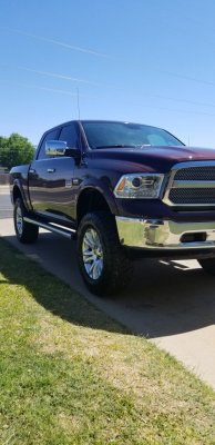

6” maxtrac lift kit( 4.5” lift spindles and 1.5” front coil spacer) 4” rear lift ( 3” maxtrac coil spings and 1” spacer) on 275/65/20 Toyo open country A/T

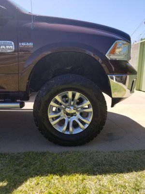

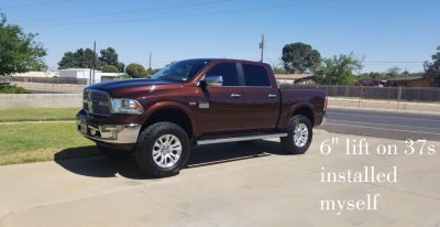

This was with the 6” lift on 37x12.5x20 Toyo open country R/T

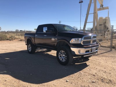

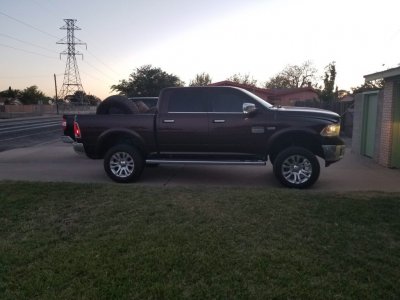

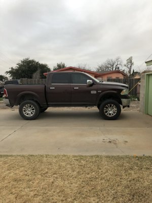

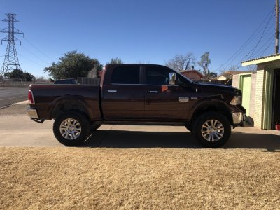

Currently now 7.5” lift
6” maxtrac lift with 1.5” zone off road body lift. Amp research power steps with Bestop rear bed step.
37x12.5x20 Toyo Open county R/T

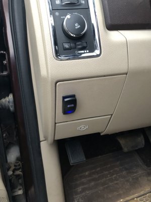

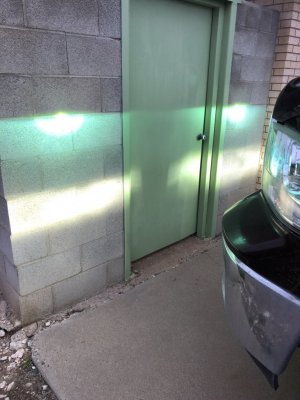

8000k H.I.D. Headlight with Pure white LED fog lights. And where I mounted my light bar switch.

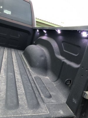

Mounted LED bed lights. With wireless remote that turns them on and multicolor change

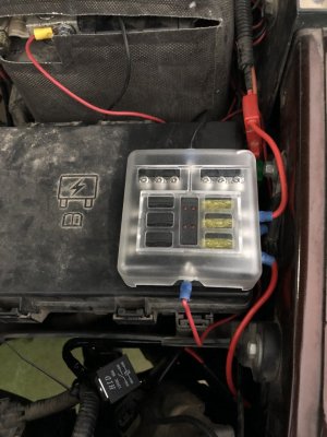

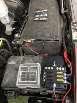

Added a fuse box that hooks into my battery that powers my light bar, bed light, and power steps. Can hook up to 6 accessories

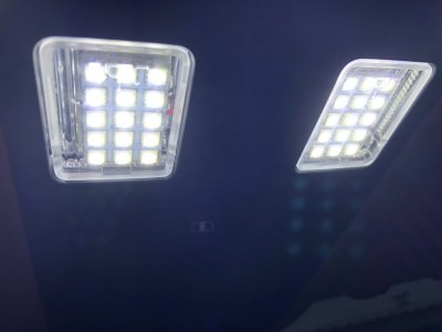

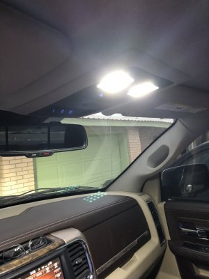

Wired in some LED panels into the overhead console. Make a huge difference in brightness over the stock LED bulbs.
