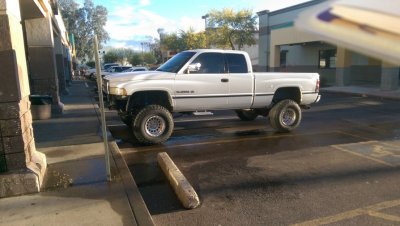

well I ended up finding a different truck and bought that today. So I finally have another 2nd gen. It's a 1997 club cab 4x4 with a fabtech long arm kit (I think it's 5.5") with bfg mud terrains. Rebuilt engine, transmission, and transfer case about 30k miles ago. Runs pretty good. The steering is shot though but that a fine. Paid $2800 for it.

Thats harsh, but not killer. Personally i'd swap it out with a 4.10.
It depends on how much you want to put in this truck, and really what you want it for. Its not bad looking, and its got potential and as long as its running sound, getting it "beefed up?" shouldn't be very expensive. I love mine and i've still got a long was to go, no lift though, I dont like them myself.
