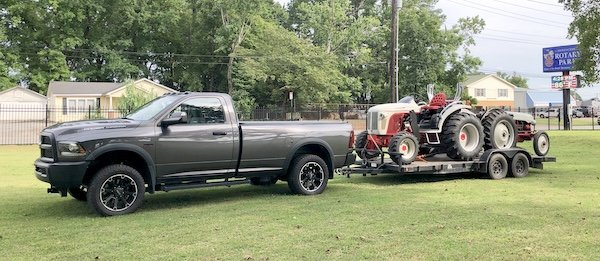

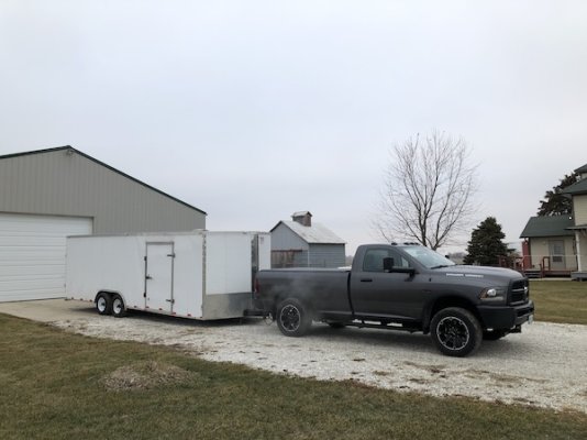

I owned a '15 2500 4x4 Tradesman with the 5.7/6sp./3.73 and it pulled fine, albeit at around 8-10 MPG depending on load and weather. Unladen MPG was usually around 13-14.
The 6sp. transmission programming is horrid. I hit Tow/Haul every time I started up, whether towing or not.
I retired and moved South in 2020, and bought the above 25' enclosed trailer to make the move. Seven trips, all loaded to the gills. Driving into a headwind for 10 hours on one of the trips, I was making about 6MPG. Prior to the move, I hauled hay and livestock with a gooseneck trailer.
She pulled my tractors fine, too.
