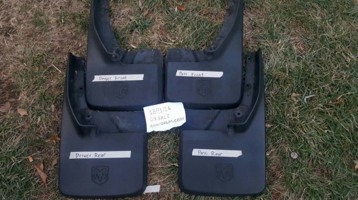

What year is your ram? I have Mud Flaps that fit an 11-14 for sale.
