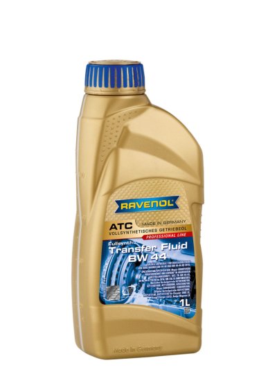

Here is an option, it not cheap
I have looked for ravenol, but haven't had much luck yet. Even at 100 bucks a litre it's a 250 savings. Spec is the Mopar fluid no specific viscosity, just a part number.
Online purchase

Online purchase
Might order the ravenol from them direct per the link. In Canada and they ship USPS.With Canada Post on rotating strikes it'll probably take a while and cost close to 75 a litre my money by the time it's in my hands, but that's half the Mopar. Haven't found a Canadian source that has it in stock.

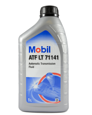

That is the specific transfer case fluid recommended by the owners manual for the 2024 ram 1500 classic, 5.7hemi 4x4.
It's basically tractor fluid, (multiple references to tractors in my search) and it's readily available in Europe, but it's not readily available in.the USA.
It has multiple equilvants, most have an Audi or Volkswagen, BMW reference and is only about $10 bucks a quart.
Obviously, it's not unicorn tears, but it's damn close on this side of the world.
So much obfuscation and hiding requirements in this industry today. "Tractor fluid" is hydrostatic transmission oil (I hate the term fluid - trying to make it sound like magic mouse milk). All HST oil is is highly refined base oil to reduce oxidation rate from heat with friction modifiers for the wet clutches and brakes in the all-in-one hydraulic system.
It shouldn't be that big of a deal to select a friction modifier additive package. Wet clutches can't be that different. Back in the day, the only difference used to be the rate of clutch lockup - some OEM's wanted faster lockup, like Ford. So Ford had less friction modifier added, hence Ford "Type F" automatic transmission OIL, compared to GM Dexron with lots of additive for a slower lockup.
<end rant>
And yes, I feel better, now.

Seems this stuff is being used in Rams north of the boarder. Do your own research though.
