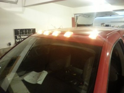

Got it done last night..... And really like it!!!:favorites13:

Nice! I know that gave me the courage to do the SWAC mod.

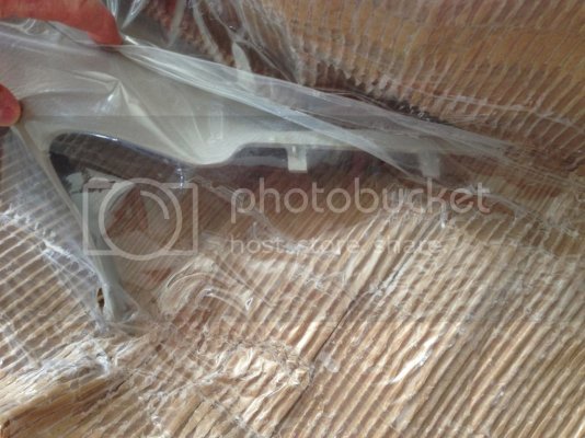

If you're confident the bolts are all the way out, I would guess the cover tabs that go in the dash panel aren't in the slots and are keeping the bolts in a bind by pushing up on the cover. When I did it, one of the tabs was not in the slot as-built and was folded underneath the pillar cover. That pic is of an SRT cover I intend to install after my radio is sorted-out.
If you think the bolts are out but the cover has them in a bind, I would try either needle-nose pliers on the bolt heads while putting some pressure on the cover to take the bind off the bolts. Or maybe just give it a good pull.
