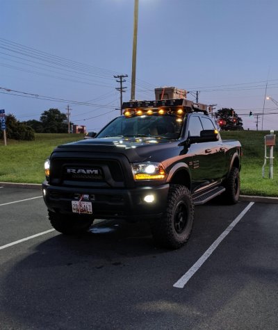

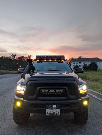

I had auxito amber bulbs in my wagon. Loved the color just not the longevity. They would last 6 months...tops. perfect color and brightness though. I have Philips bulbs now and they're definitely a darker orange than the auxito and not as bright. Here is a pic of mine last year with auxito bulbs and now with Philips bulbs43356823a221d7444b8511dda6c5ed1a.jpg3f34b2c9a250626ced2157e77c2fc477.jpg

Hmmmm, yeah I can definitely see the difference, and I do like to look of the auxitos, but that lifespan is not appealing, the less I have to get in and out of those cab lenses the better!
Truck looks great BTW!

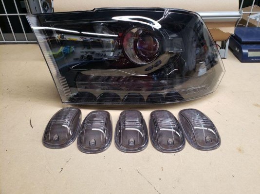

The amber MOPAR clearance lights were to bright out of the box and I didn't want all black. I wanted them to go with the amber in the projector headlights . Tint and many coats of clear worked perfect for what I wanted. I used the earlier amber MOPAR lights which have never given me a problem of any kind in the past . Reinstall tomorrow

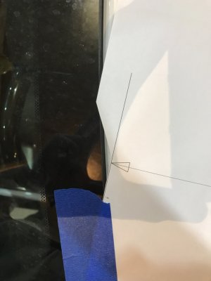

I’ve got the template taped down and it’s even side to side, my question is do I line up the front arrows with the edge of the roof, or the edge of the glass?

Keep them back rather than fwd. Been there myself. It will work well.
