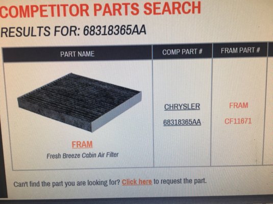

Ok, changed my cabin air filter this morning. Yes my 17 express is factory equipped with one. I tried cross referencing the Mopar part number and it crossed to a wix filter. Crossed the Fram number and the Purolator number c25858 came up. Exact replacement. I couldn't believe how dirty the old one was. It's been in there less than a year. I change my cabin air filters every year, bought one for the wife's grand caravan also, it's coming up on a year for that one.

My 2017 ram 1500 Laramie has the cabin air filter.
Here is the picture of the part number and the cross reference for a filter.
