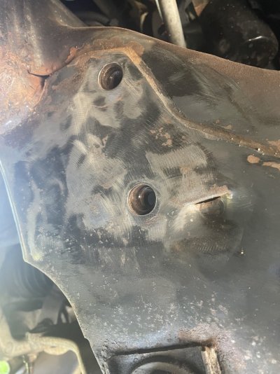

Since I already ordered the same front sway bar (and new metal brackets), I decided to clean up the rust where the mounting brackets go for the bushings. There was a fair amount of rust in that area.
I hit it with a 4 inch grinder with a flap disc sanding pad, and a small wire brush. Some of it is down to bare metal.
What should I prime and paint this with? I’m not sure if self etching primer and black enamel paint is correct?

front sway bar is not needed on a IFS truck. just chuck it in the trash were it belongs
I just wipe things down with Acetone,then hit them with a semi gloss black rust paint,seems to work and lasts quite awhile. The diff under my truck was from a 2011 truck,i geve it a quick sandblast/wipe and wash down with Acetone then sprayed it with Tremclad semi gloss black rust paint,and that was 10 years ago,and it still looked brand new when i sold the truck awhile ago.
Is Tremclad a Canadian product? Many of the links are taking me to Canada based websites. And how many cans did you use on the underside of your truck?
