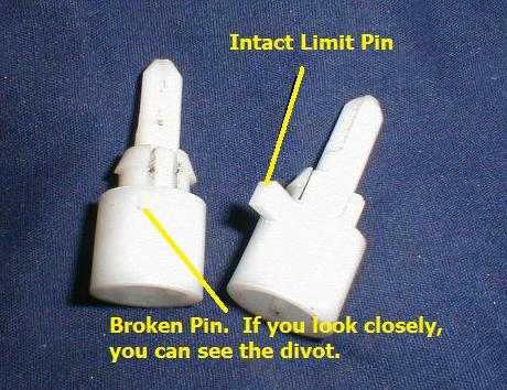

Did the WHITE thing , ( DOOR SERVO COUPLING ) , that allows the Actuator to move the DOOR inside of the HVAC Box, pivot the door as it should, when you use your thumb & finger to rotate it ?
