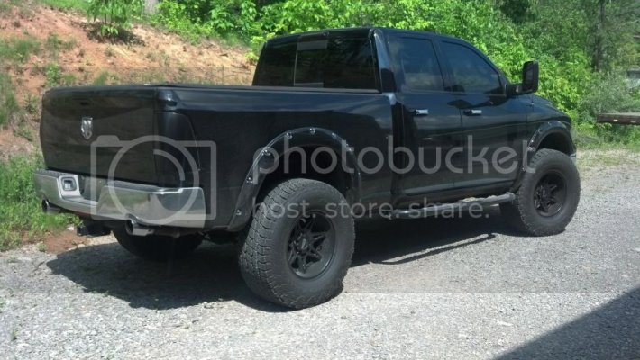

The factory tips have a weird set up on them. Like a flange. You can loosen them (takes some beating around because there is a tack weld) then turn them up and tighten them. I couldnt find an exhaust shop I trusted and I discovered this when I was messing around underneathe there. A pic of mine from behind with 3" body. Some angles it looks weird with your tips going up but its free and looks better than the tips hanging down.

the shop you talked to was right that your exhaust tips would be low, but the cost to offset them up should be a hell of a lot cheaper than a suspension lift and labor to install. Go to another shop because they are just after your money
