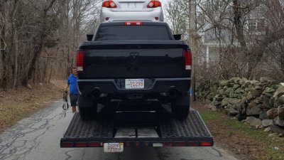

So, after taking a break from all of the build stuff. Been a couple years. My girl is hurt. 2013 30,500 miles. 5w20 RL oil changed twice a year regardless. In her defense, she's pulled hundreds of WOT runs. She's been airborne and sideways at 90mph. Few other things I'm sure I'm forgetting. She will be taken off Island this weekend and transported to modern muscle extreme next week for the teardown. Dave's going to take real good care of her!

Nothing really! Just went one afternoon started her up. Terrible lifter noise after a couple of minutes went away. It's just a perfect excuse to the wife for spending $$$. She's all in! Happy wife, happy life
