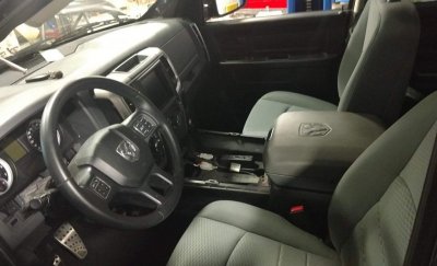

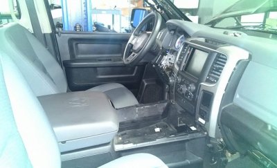

Just an update on this build! After a lot of back and forth with modern mopar extreme concerning what engines, etc for the last 2 months: we decided on a whippled forged 426 with an 8 speed conversion. With all the supporting goodness. Took a while to find a doner truck for the conversion. Engine is being built by MMX and transmission will be built by Paramount! Dave Weber @ MMX is the most honest, true to his word guy I've ever dealt with. He really knows how to reach a goal and get the biggest bang for the dollar. As the built progresses, I will document as much as possible the 8 speed conversion so everyone gets a good idea of how involved it is.

All in at $57,500+trucking fees. $27500 for Hellcat, stroker kit with billet forged crank, blower, full updated fuel system, etc. $30000 for donor truck, built 8 speed/transfercase, driveshaft, etc.
You can definitely do this cheaper with a 6.4 engine and whipple but I went with the Hellcat because of the 10 rib drive system oem reliability. Numerous reasons really. Not to mention wow factor. Not only a Hellcat but 426

It really depends on what you want. MMX has 5-6 options for engine stuff not to mention crate engines. Stroking your existing 5.7 is the biggest bang dollar for horses in my opinion. It's just when you start upgrading oil, rockers, crank, caps, fuel and the countless things around the numbers that ch*t starts hitting you hard.
If you already have the 8 speed, you're ahead. If Not, all you need is the new powernet communications for a 8hp70-75 or 8hp90 swap. But there is a ton of work into a 8 speed swap. Right down to emergency park release. We went with the donor just in case I didn't have the new communications. So my 13 is now a 15. Labor cost is high.
