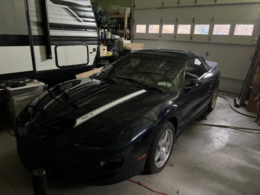

Working out of my Trans Am now!

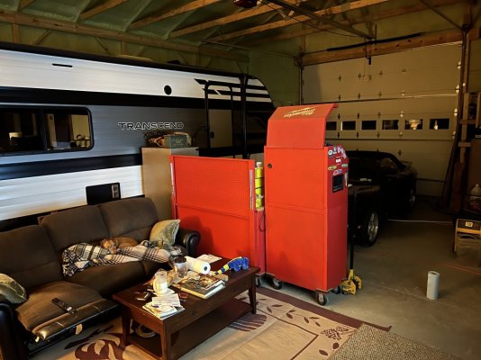

Now I live in a garage…no room to work on anything in depth! Basics! Oil changes, brakes, maintenance items…and my body hurts after rolling around on concrete!

It’s definitely simple living! It’s not for everybody, but it works well for me…and Apricot!
Life here is good!
