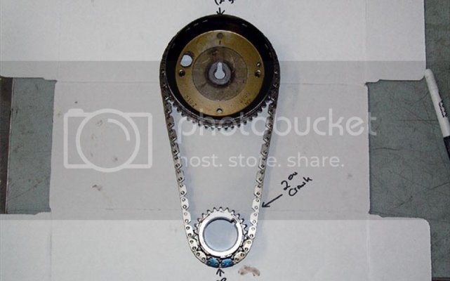

As far as degreeing the cam you can just put cyl #1 at TDC and then use the marks on the timing chain, cam and crankshaft sprockets, its pretty straight forward.
mopp_0602_18zdodge_hemitiming_chain_zps9a329528.jpg"]mopp_0602_18zdodge_hemitiming_chain_zps9a329528.jpg[/URL]
As long as the person who is doing the tune knows the specs of the cam I don't see why you would need to degree it.
