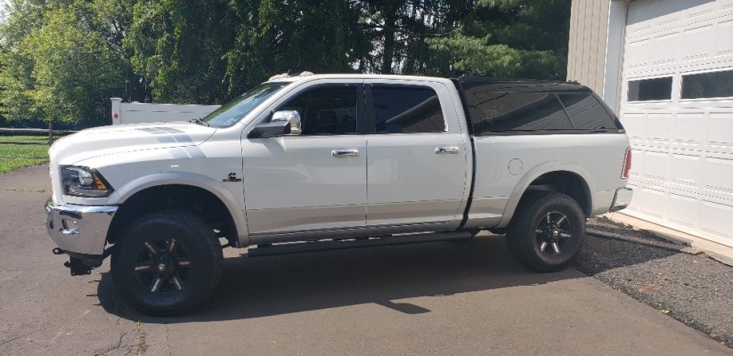

The rear of the cabs are different on quad and crew cab. Not sure which rear the regular cab has. The quad cab is slightly more upright than the crew so... A quad cap would fit a crew but I don't think a crew would fit a quad if that makes sense. I'll attach a pic of my crew cab with my cap. It's from a quad and you can see the contour is slightly different. I bought this used over the summer. It was black when I got it. I bought $300 worth of vinyl and wrapped it white. Color is not perfect but close enough for me. 5d19f5bfdde3da9d67a78fdf00a3d9aa.jpg
^^^ this
@ctf0015 the cap should fit if it's for a 5.7' bed as those are only found on Crew Cab trucks. The problem described above can happen with the 6.4' bed as it can be behind all three cab styles.

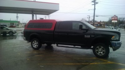

I bought this 8 ft. Jason mid rise off a 2012 for $300 paid $1200 to fix 1 crack and paint. As long as both trucks have the same size box/bed it will fit. Just make sure you have clamps to fasten to your truck.
TTACH=full]237306[/ATTACH]

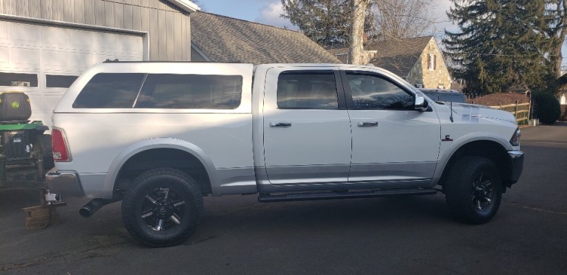

The rear of the cabs are different on quad and crew cab. Not sure which rear the regular cab has. The quad cab is slightly more upright than the crew so... A quad cap would fit a crew but I don't think a crew would fit a quad if that makes sense. I'll attach a pic of my crew cab with my cap. It's from a quad and you can see the contour is slightly different. I bought this used over the summer. It was black when I got it. I bought $300 worth of vinyl and wrapped it white. Color is not perfect but close enough for me. View attachment 456578
Sent from my SM-G965U using Tapatalk
View attachment 456579View attachment 456580
What vinyl did you get? Would you do it again or paint it?
